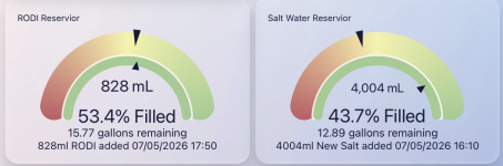

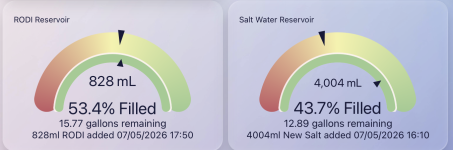

Well, I took the integration and built a dashboard that combines Hydros, Red Sea, and Input from HA. I use Conditionals to show certain items like when my Salt Mix sensor is low and time to make salt. I also use a Simple Swipe Card and placed Expander cards within that. Screenshots attached. The integration is very nice. A lot of us have been waiting for something like this.
Every now and then I have to Reload the integration to reconnect.
