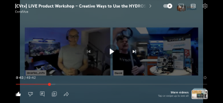

how do I make this happen? There was an out of the box solution alluded to on a cvtv episode but doesnt look like it made it to market…I’m not savy with this kind of diy.

what happened to this light????
Hard to say, but I would buy it. The video was from Jun 17, 2021, over 1.5 years ago. I have heard it can take two years to bring a product to market. Maybe CV is still working on it.
