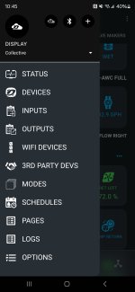

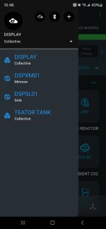

WHen you create a collective you won't see the devices individually. At least not via wifi. There will be a list of devices below your left dropdown when you initially enter the app. You'll see the collective name with the word collective in small print below it. Then clicking on the collective nane you'll connect and all of the members will be visible below a single virtual device if you will. At this point you will be able to.share inputs to operate outputs on another control. The only way you'll be able to see and control (manual override only) individual devices the way you previously had will be via bluetooth. This is normal behavior. I personally think you may have successfully configured a collective and possibly just don't know what you're looking at.
See how mine says DISPLAY (which is my collective name) with Collective in smaller print.
Then if you click the down arrow to the right of the name it'll display other collectives or individual devices that haven't yet been joined to a collective. See below.
In order to see this you need to transition from Bluetooth to Wifi/Cloud by clicking on the cloud symbol in the top center.
