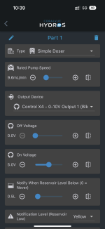

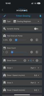

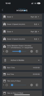

Question for those using the red relay module boards... are you able to wire the 0-10v analog signal directly to the digital optocoupler trigger on the relay board? I see HIGH is digital 2.5v-5v
ChatGPT suggested I put a transistor between them. Simple enough and I have spare parts to do it, just wondering
For the parts I have on hand, I was thinking of this for each input
I think AI has lead me horribly astray here, sorry I cannot edit my own post to correct it. :confused:
