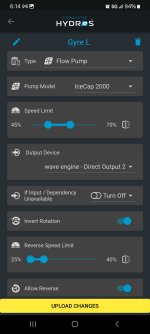

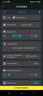

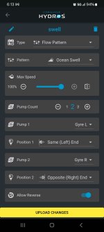

I have 2 ice cap 2k gyres. In ocean swell they both are forward at the same %. I would like to move one side forward one side reverse if possible. They schedule has been uploaded.
Can you tell me why you have Invert Rotation Active? This feature is only needed for a very specific purpose.I have 2 ice cap 2k gyres. In ocean swell they both are forward at the same %. I would like to move one side forward one side reverse if possible. They schedule has been uploaded.
The invert is on because both gyres run in reverse while showing forward in the app.Can you tell me why you have Invert Rotation Active? This feature is only needed for a very specific purpose.
Have you submitted a ticket so we can work with you and figure this out? CoralVue Support PortalThe invert is on because both gyres run in reverse while showing forward in the app.
