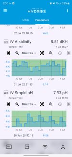

I have been running my x10/iV for around 7 months now, and wanted to know how consistent results are expected to be.
My results vary from several different salifert test kits by up to .5 dkh (after -1 offset included) and swing wildly 4-5 times a week (8.5, 6 hours later 7.9 and back again to 8.3, manual test is 8.1-8.3 for example).
I have recalibrated the pumps and ph probe regularly, and I clean the probe per pinpoints instructions regularly too. These swings are not consistently months after calibration.
I have tried all the steps in the set up thread as well, to the best of my ability.
Also my ph readings seem more reasonable, so I don't think it is the probe. Even between wildly varying dkh tests the ph is right on pattern (the graph looks about right each day +/- .05 for example).
My tubes are ultra short for reagent, and only a couple of feet to the sump, and I do not see visible bubbles.
Is inconsistent reading +/- .5 dkh expected, and if not what can I do to make this work enough to trust the results?
Thanks for any help!

Have you submitted a support ticket? If not please do. Alkalinity is the most violent measurement and can vary quite a bit . Try testing at the same time each day , Once per day. Then you will see what you're consumption rate is . It is not uncommon to see alkalinity swings during the day. If you have more questions please feel free to submit a ticket. :)
