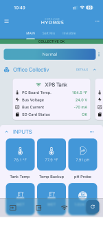

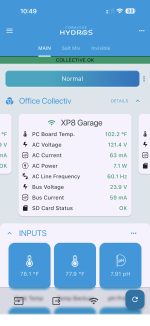

The other day I got a notification that several of my devices plugged into one of my XP8's were drawing zero power. Upon going to the tank to look the devices were all functioning normally. I noticed however that the XP8 has red and white lights flashing on it. Also, in the app, when I go to my status page and look at my devices the XP8 in question now only shows PC Board Temp, Bus Voltage, Bus Current, and SD card status. My other XP8 however shows PC Board Temp, AC voltage, ac current, ac power, ac line frequency, bus voltage, bus current, and SD card status. Anyone know what might be going on?
For anyone else with this issue...
I contacted support and got in touch with Michael. He had me power down the entire system and power it back up. This fixed everything. Apparently the XP8 wasn't getting good power somehow. Not sure how this could be, but who knows. It wasn't showing all the available info on the status page since it believed it didn't have good AC power. This was even though it was still powering the AC devices plugged into it. Everything in the app now appears as it should and I no longer have blinking red and white lights.
