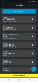

Not as important, but it would also be nice to see the additional child outputs on the Outputs summary page.
