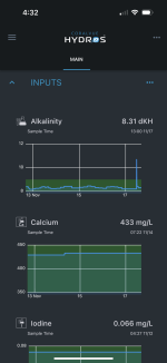

I have my Alkatronic configured as an input, but after running a test after a reagent refill and there being a fair amount of air in my lines, I had an artificially high reading quite a bit higher than normal. The next test I ran was back to normal, but now I have a high spike in my Alkalinity graph, which squashes the rest of the graph data so that it can show this new high point. I know in 5 days it'll go away, but would be nice if there was a way to review/remove data points for inputs.
