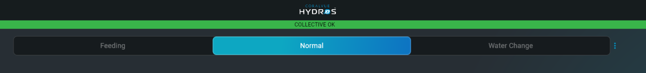

Having a hard time figuring out the best way to automatically go into feeder mode at set times throughout the day. What is currently the best way to achieve this?

Thanks for the detailed reply and apologies as I was overly detailed in my post. I guess the better question to ask is if there's a way to have the Hydros collective automatically switch modes from normal to feeding, etc.

There are feature requests outstanding to have an output trigger a mode but ability does not presently exist. The current workaround is to create a virtual Combiner output referencing the feeder as its input, set a max on time (the duration you want the simulated "mode" active) for the combiner, notification level none and make the return pump or flow pump schedules depend on the combiner output. A virtual output is an otherwise normally configured output just without an Output Device specified.
I was pulling my hair out trying to figure this out. So without this work-around, Feeding Mode is just a manual mode?

That seems to be the case. I'm basically in "Normal mode" 24/7 and have my return pump dependency relying on the power of the auto feeder. For example, my auto feeder pump turns on at 10 am (The Plank Feeder). When the auto feeder pump turns on my return pump turns off, and so does one of my powerheads. (Dependent option - off if on) after 2 minutes, the auto feeder turns on and runs for a specific number of seconds. I have the auto feeder pump run for about 10 minutes while the feeder only runs for 10 or so seconds - that way the fish have time to eat and I can ensure all the food leaves the feeder chamber. After the interval for the feeder completes and turns off, the return pump and power head turn back on. I have this occurring twice a day and do a prepped meal in the evening.
