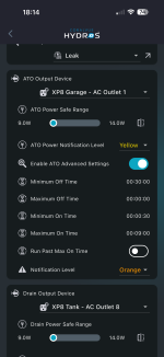

This has been my experience exactly. With the triple level sensor the ATO was only running maybe 3 to 4 times a day and I saw more water drop than I care for between running. I switched to the optical single sensor and now it runs more like the Tunze I had. It's actually running TOO often. So, I went in and set the minimum off time to 30 minutes and the minimum on time to 30 seconds. I figured this would make it run less often. Unfortunately it seems to ignore those settings entirely. Unless I'm doing something wrong. See screenshots.
I’m confused by these logs. I would expect to see turned on, running, and turned off. Why all these idle entries?
Mine has the idle statements also. Below that are my ATO output settings in the AWC output. I am using Sole pump at a flow rate of 55ml a minute. My minimum off time is just 5 minutes but it does not usually cycle on that often.
Do you know what the idle entries represent?
I don't know but have not paid a lot of attention to the log since the ATO is keeping mine at the high level sensor.
EDIT I got to looking and it may be when the sensor is wet but the minimum run time has not expired sine the ones I checked only run for the minimum on time I had set.
I see you made an edit to your post earlier and I was just about to say the same thing. It seems to go to idle when the upper sensor goes wet and the runtime hasn't expired. At least now I know what it represents.
