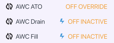

I’ve verified that the diaphragm pumps work when triggered manually, but the schedule doesn’t run at all. Here’s what I see in the Status:

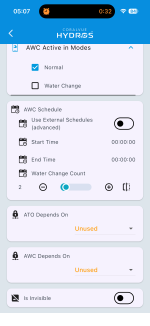

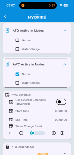

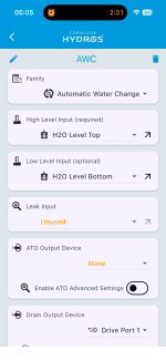

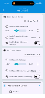

What am I doing wrong? I tried both the internal and external scheduling, and they don’t work. My Auto Water Change Output setup is below:
