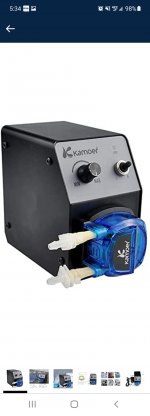

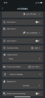

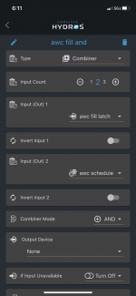

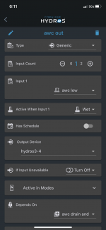

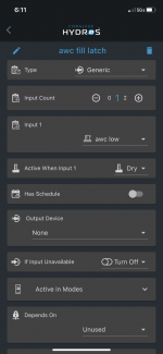

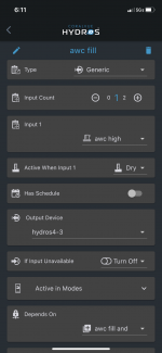

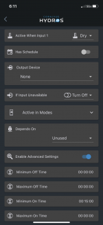

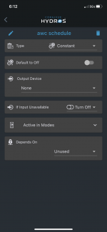

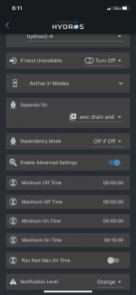

I pull the water out at the same time I am adding so no need to turn off any other pumps. I have both pump heads on the same pump now and it is in the garage which is 35ft from the tank. So the water that drains the tank pull from the refugium section of the sump and dumps it to the drain on the kitchen sink. All the tubing runs up through the attic. So height does not seem to be an issue. I did check to make sure both the fill and drain pump head was adding and removing the same amount by placing a container at the sump with a measured amount of water in it and placed both the fill and the drain tubing in the container. I ran the pump for an hour and check the water level. I do have a sump overfull and a sump low sensor at will stop the AWC if either is triggered. It will trigger if for some reason one side does not work before the 11 minutes is up. Also once trigger for low. My ATO will not refill before getting a max on time has been exceeded alert along with a sump low alert.
