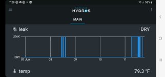

Here is the graph I never really looked at it.

To reboot when there is a specific issue I power it down and wait a few seconds and power it back up. On the 8th and today are the only times it was active from the graph. Not sure why you are not getting the audible alarm but I don't think it is the sensor itself since you said it turned the pump off. I would submit a support ticket for this here Submit ticket .
