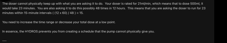

Hi ive had a simple doser setup dosing all for reef but id like to switch to kalkwasser. im trying to setup a dynamic dosing regimen for kalkwasser using my ph probe. It wont allow to me select my doser because “doser 1 runtime to low” but i believe runtime is 12hrs so i dont understand. Doser is 43ml per minute so it would need to run for 11.5 min every 15min for 12 hours.
Ive contacted support and they keep telling me my doser is 21ml per minute when its clearly stated on their own website that its 43ml per minute and ive calibrated to make sure its 43 ml per minute and have done manual doses to make sure its accurate.
I may be doing something else wrong but its definetly not because my doser is 21ml/min. They replied twice saying the same thing and i feel like they dont even read the email. i do appreciate that its sunday and they are still responding but its not helpful.
Input - ph probe
low point - 8.1
high point - 8.4.
Low point dose - 500ml
High point dose - 50ml (pic says 10ml but i changed that to 50 and saved changes)
If stale dose - 0 ml (is this correct ?I figure if i dont know what ph is i dont want kalk dosed. Also what would cause inactive or stale input ?).
Dose count - 48 (12 hrs dose every 15min if ph below 8.4)
Doser count - 1
Doser 1 — here i try to select my doser but i get red bar on the bottom saying doser 1 runtime too low
Run time 2100hrs and 0900 hrs so 9pm to 9am
Active only in normal
