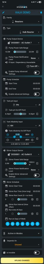

For future reference, it always helps if you share a screenshot of the configuration you're working with. Guessing you may have been trying to do something below advanced settings and minimum/maximum times which are often misunderstood. There is a built-in kalk reactor recipe which manages most kalk stirrer and pump use cases. Try Reactors >;Kalk Reactor with something like this:
Change pump schedule advanced settings if you want to restrict when or how long the pump runs. Know that by default the pump will NOT run while the stirrer is running. And Alkalinity input can be left unused if you don't have an automated tester such as X10, Alkatronic, Carer, etc.
