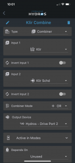

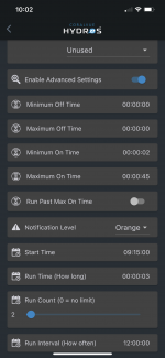

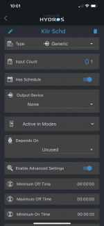

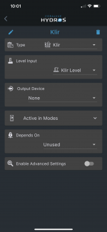

I still find my Klir a little finicky in that water will get by and never trip the level. So I used a few
Tricks I saw on here for other stuff. Just sharing this specific use case if useful,
. I have a Klir output for the level sensor and another generic output for a schedule. Then I use a combiner with an OR to drive the motor. So far so good.
