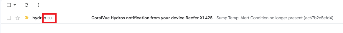

I had my temperature right at the limit of where I throw a notification. I notify at 79 degrees and the temp got right on the edge of that at ~79.03. I got 30 notifications over 30 minutes about the temperature. I changed my notification limit to 79.5 to stop it, but a nice to have feature would be if there could be a 'cooldown' timer to keep the same notification getting sent too rapidly.
