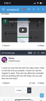

Is there like a one response per day quota to these support tickets? Only suggestion was to replace the Wi-Fi strip, which when I opened the ticket I provided a link to this thread. Where I’ve already received that suggestion as well as reported it didn’t work. I responded with a bunch of information and YouTube link of what happens after replacing. I had my reply in within an hour or so of Carlos’ response and I haven’t heard back, and vid has no views.
I even tried a magnet reset today and it ended up doing same thing.
What I am wondering is, is there any way my old Wi-Fi settings are being used again somehow? I wasn’t able to start from complete scratch within the hydros app, like it saved all my inputs/outputs think if I remember right.
If anyone else has any tips they’d be appreciated. Think I can get a better temp set up tonight to hold me over so i should be able to maintain my chi a bit better
I could not view the link with the video when I tried on the first one you posted, I would not use the magnet to reset. That will only affect the controller and not anything with the wifi strips. Do you just have the one strip?
Weird. I can see the video is posted what browser are you using? I can watch without even leaving the thread it’s a YouTube link not iCloud like first…
Yes. Just one strip.
I tried magnet cuz I don’t know what else to do here. Not getting any suggestions other than what I’m posting a video of not working
Edit: I was referring to this same YouTube link I posted l, I wasn’t saying no one watched the iCloud link.

You were programming quickly after you did the pairing. I usually let it sit several minutes after the pair is complete before I try doing anything with the wifi strip. If you use replace it should replace what you had already programmed in without reprogramming. But I guess since you did a reset all the settings were erased. Try plugging in the wifi strip within a few feet of your router and see if it starts responding.
