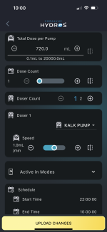

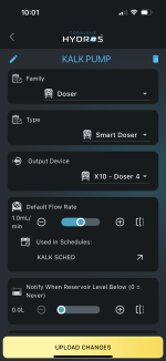

Don’t want to mess this up here, but if I want to dose 1ml/min of kalk off of an X10 pump, will this work? Programming the pump to flow at 1ml/min, run the total dose 720 ml, dose count 1, run times 22:00-10:00? Then program the output pump at 1ml/min with the schedule attached? Don’t want any dependencies just a straight up nightly dose… does this jive?IMG_7843.pngIMG_7844.png

I understand but if you need another in the future then that would be one you could use for a similar use. It is a smart doser like the X10 but will go from .1 to 300ml a minute in both directions. It can also be setup for continuous use in the app and then controlled using depends on from a different output. The Minnow pumps can also be controlled like this but they cannot get a low enough flow rate for your use. I have one setup for ATO but use the continuous use feature and control it with my original ATO output instead of using a schedule.
Yea I get the capabilities, I don’t mind, in fact I enjoy, having a couple devices that are not integrated with a Collective. My Kamoer pump handles as low as .1ml/min and I have no need to replace it.
