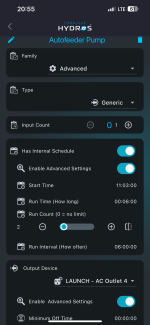

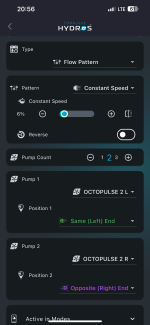

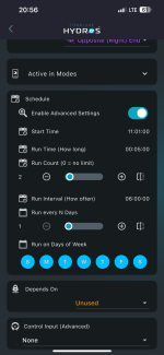

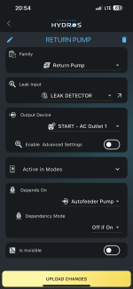

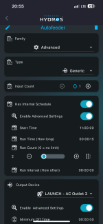

I apologize if this is already a feature that has been added, but I can't find a way to schedule modes. I want to schedule the modes so I can activate feeding when my feeder feeds. I can't find a way to control everything adequately with the hydros wifi feeder. I don't have a wave engine, and I don't use any wave engine compatible pumps even if I did.
Basically what I am trying to accomplish is this:
Feeding mode Activates at scheduled time
Skimmer turns off
Return pump turns off
Feeder turns on and rotates
5 second delay, and circulation pump turns off ( I want it to run for a few seconds to make my pellets descend for my goby)
10 minutes later switch back to normal mode
Is there any way to make something like this work?
