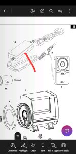

The red line is where I want to cut the Sicce pump power cord, correct? Between the T that adds the controller into the power cord and the power brick?

since I can't do this in DMs....
you could cut anywhere in the highlighted area. Then splice that to a barrel to connect to Force port. That or wait for your M16 connector to come in and wire that.
Yes, that is exactly the spot I had figured, somewhere in that stretch of cable.

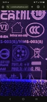

For the Siccce Syncra SDC 7.0 I read this thread and the pin out thread. Just wanted to confirm the pinout for 24v power, 1/2 tied together for ground, and 3/4 tied together for 24vdc power. The notch is on the right side in the picture below?
What confuses me is that compared to the power supply pinout.

To review, I cut the barrel connector off of a 24V Force Port cable & wire it per the Kraken pinout posted here. I can cut a bit extra of the force port cable to make the jumpers, correct?
This may be a dumb question, but the black wire from the FP cable goes to pin 1 & the red wire from FP cable goes to pin 3. Then the black jumper goes from pin 1 to pin 2, and the red jumper goes from pin 3 to pin 4. All of this with the notch on the connector on the right side as I'm looking at the connector, just as the pinout diagram posted. I just want to make sure I'm doing this correctly. I was a tile & marble contractor all my life which is obviously far from anything resembling an electrician. 😊
