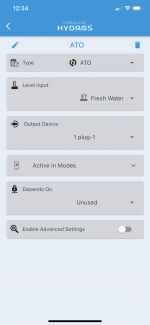

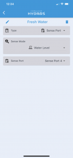

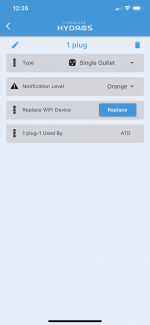

I’m new control 4 user this weekend!! I got most figured out. I have not been able to get this though. I have a single WiFi plug that I want to plug my tuze ato into. I also have a water level sensor that I want to put low in Reservoir to turn plug off when it sensors no water. I can’t seem to figure it out. I have one sense port left for it.

yup just like I suspected. Didn’t work. Here is my pages

The sense port recognizes when dry just doesn’t shut plug off. Maybe not possible idk
That should work. Can you post screenshots of the input, the output to follow the input and you drive output. I will check it out.
SorryI didn't the previous post. You cannot use the input directly like you are trying to do. You will need to use output to follow the input and then use the constant on type and not the ATO type. Then use depends on with the output that follows the input to turn off the output. The input is ok the way it is.

The input in the ATO type is for the sensor in the sump to turn on the output when it is dry.
