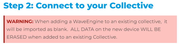

Known issue. Guess I should have RTFM. Maybe consider adding this warning to the App and/or clarify that "ALL DATA" = "All configurations". Just a thought.
This does not just apply to the WE. It applies to any controller added to an existing collective . So adding a second , third , fourth etc etc will be imported blank. This has been this way since day one of the Collective interface. We recommend doing all programming to those additional controllers AFTER you have added them to the Collective. :) STEP 2. HYDROS Control - Adding to Collective
