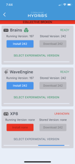

Others have had to try several times but it did eventually download for them.I keep trying to download update on my XP8 and it stops and won’t push through… downloaded for my WaveEngine and X4, and app is up to date. Tried it twice now it won’t finish. Any help?
Try the following:I keep trying to download update on my XP8 and it stops and won’t push through… downloaded for my WaveEngine and X4, and app is up to date. Tried it twice now it won’t finish. Any help?
Line of sight is the exact same as other devices that downloaded no issue. Will try to reboot my devices and try again.Try the following:
1) Restart your router and access point if you have one and wait until you can browse the internet
2) Restart your HYDROS devices
3) Try to download the firmware again
See if that helps.
Also, check line of sight. Draw an imaginary line between the router and the offending device and see if a body of water (aquarium or sump) is directly in the path. WiFi cannot travel through water; if the device is blocked, it would explain the intermittent connection. Moving the device or the router might help the problem.

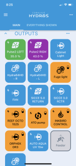

My ATO pump kept running… panicked for a minute thereFirmware upgrade turned all outputs to on for me, including the dosing pump .
Yep that is what I didit is likely that you installed the firmware one device at a time instead of downloading to all the devices and subsequently installing it on all the devices. Is that what happened?
