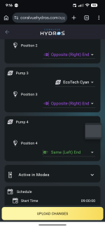

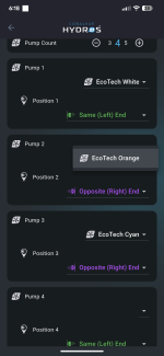

Looks like it's the existing schedules that are broken. If I create new ones Go figure!When I click on the arrow for position in the schedules I get the selection menu and I am on firmware 374. Did you setup a output for the 4th pump?
