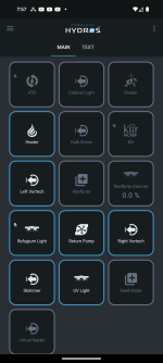

Sounds like that's out then. I ordered the XB8 and a new auto feeder, which I should get early next week. I'll cross my fingers and hope that fixes the issues I've been having. I guess I can look into a standalone auto feeder if I'm just unable to get WiFi devices to work again for some reason. I would just replace my router but it's one of the spectrum provide ones and it's working fine with everything else. Still weird that my X4 itself isn't having any issues connecting to WiFi but all the other WiFi devices are completely inoperable. Any chance this is an issue with my X4? It sounds like the other devices mostly supposed to communicate with the X4.

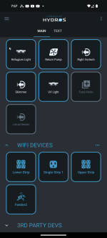

Funny thing, I actually just remembered I had purchased an extra auto feeder years ago. I tried replacing the current auto feeder with it and was able to successfully connect it through the app. Even though it went through successfully, it still shows as not responding in the app though. This kind of makes me feel like it probably isn't really an issue with my WiFi or router. That and the fact that the X4 isn't having any issues connecting. My Google cameras, TV, smart lights and all other WiFi devices also seem to have no issues connecting. Seems like I'm the only having this issue though so it must be something on my end.

Seems like everything is working again. Just hopefully it stays stable like this. I contacted spectrum and they were able to "steer" my mobile phone the the 2.4 ghz channel for an hour so I could try connecting everything. I ended up needing to go back to them for another hour because the auto feeder was giving me issues. Speaking of the auto feeder issues, something weird happened when I was trying to set it back up. I was unable to get my original auto feeder or the unopened one I had to connect successfully, regardless of whether they were on my tank or right next to my router. I had just purchased a cheap WiFi auto feeder of Amazon with the plan to run it independently using it's on app if I was unable to get WiFi devices to work on the hydros again. I was weirdly unable to get the cheap auto feeder to connect to it's own app but I was actually able to connect that one to the hydros. So the two hydros auto feeders were unable to connect whether I tried replacing the current one in the app or adding a new one. Just tried the cheap non-hydros feeder on o whim and it connected through the hydros app on the first try. So, at least I have an auto feeder working right now. Not sure why the other two were being difficult though. Thanks for all the help sorting out my output and fallback issues!
The wifi feeders probably use the same protocol so the Hydros just sees it as a Hydros feeder. The wifi feeders are made by another manufacturer so the one you got could even be the same manufacturer. The same applies to the wifi strips. They are Tuya protocol power strips and I have seen the exact same layout on ones at Home Depot with a different name and color. My guess is that those would probably pair with the Hydros also. The price was not that much of a difference and the Hydros comes with a mounting bracket that the ones at Home Depot didn't have. So I just get the Hydros ones when I need one. I have 4 of them at the moment and still have open outlets on them.
