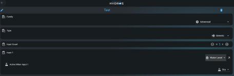

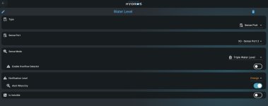

I'd like to use my Triple Level Water Sensor 1) to notify me when the sensor is dry and 2) to disable my ATO and Doser outputs when the "Safety Sensor" level is reached.
The first was pretty easy, I set that up when I was adding the sensor as an input. The second I can't seem to figure out. Using an "Advanced Output" and the Water level sensor as the input, the only options are "Dry" and "Wet". Is there a way to set it only when the "safety sensor" is tripped? I want the ATO and doser to function as normal when the sensor is dry, and when the sensor is at the the normal level ("Wet") but only cut off when the "safety level" is reached. Can this be done using one sensor? If not, seems that the triple level sensor is pretty useless. TIA!
