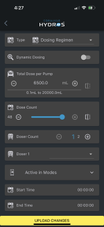

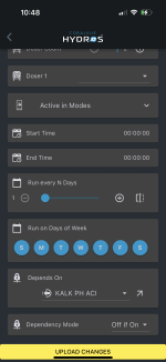

I’d do a schedule that runs every “x” mins. So if you do a dosing schedule, you’ll enter the total ml’s per pump, the times you want it to run. So 48 times will dose every 15 mins, the amount you entered divided by 48 each time. You can then enter a “depends on” outlet that will shut it down if the level sensor is too high. This way, you know you’re not going to dose more than the set amount even if the sensor is too high due to a malfunction.ok I get that. My schedule is 7450ml max dose. Per night. As I dial in my evap. I want the sensor to stop the doser if I dose too much. That and I am checking all and ca.
So I do have a schedul. Is this way good?

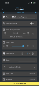

Pics are just an example. You’ll need to enter start/stop times, and adjust the pump flow rate. Might even be back to 100ml with that amount.
