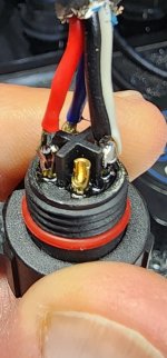

Awesome Info Don. I was worried if I did wired it incorrectly it might be damaged. Yes, you are correct Apex has nothing like this pump controller. What I use as a pump controller for the Apex is a WS55-180. Then use the 0-10v output to control the pump speed. My skimmer, UV Light and return pumps are all running off these WS55-180's. I also have 2 icecap 4k gyre pumps that use the dual controller. My dual controller has an issue. It's reading the 0-10v incorrectly. If I input 10v it reads 4v, if I input 9v it reads 7v and if I input 8v it reads 10v. So the plan was to use this instead of buying another dual controller. I could get rid of three controllers and only be using one. Thanks Don!
