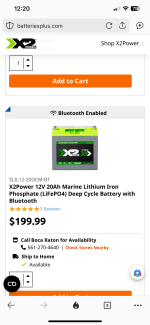

Hello. Will a 12 VDC 20 ah Marine lithium battery be able to power the Wave Engine 2. I have all the cables.

The answer is yes. I have a TalentCell Mini UPS dc output connected to the WE2 power in with an icecap battery cable. I have the WE2 set to low power/battery mode/schedule. Both octo 4 pumps are running at 50% power. I am logging the run time and will report back here.
Here we are 24 hours later and both my octo 4s are still running but no longer at 50%. Hydros show only 2 watts consumption down from 5 watts total when they first switched to battery back up. This is very good news and I imagine that with a larger marine type battery these pumps would go for 5 days. Great pumps to have if you live in a state where you have to worry about power outages like Florida.

Normal operating state is 24V. When you're in low power mode, the Wave Engine is operating at 12V. So while you're at 50, that is actually approxumately 25% compared to normal when you factor in the voltage drop. And that is fine because at this point you're just looking for some circulation and oxygenation to maintain life. Good to hear it's working as expected and hopefully normal power returns soon. Just remember, after the fact the TalentCell will require its own charger as Kraken's internal charger only supports lead acid.
Good to know. Thank you. The Octo 4s were still running after 24 hours. This is more than enough time to fire up our gas generator. The WE2 is a great addition to our 120 gallon reef tank.
